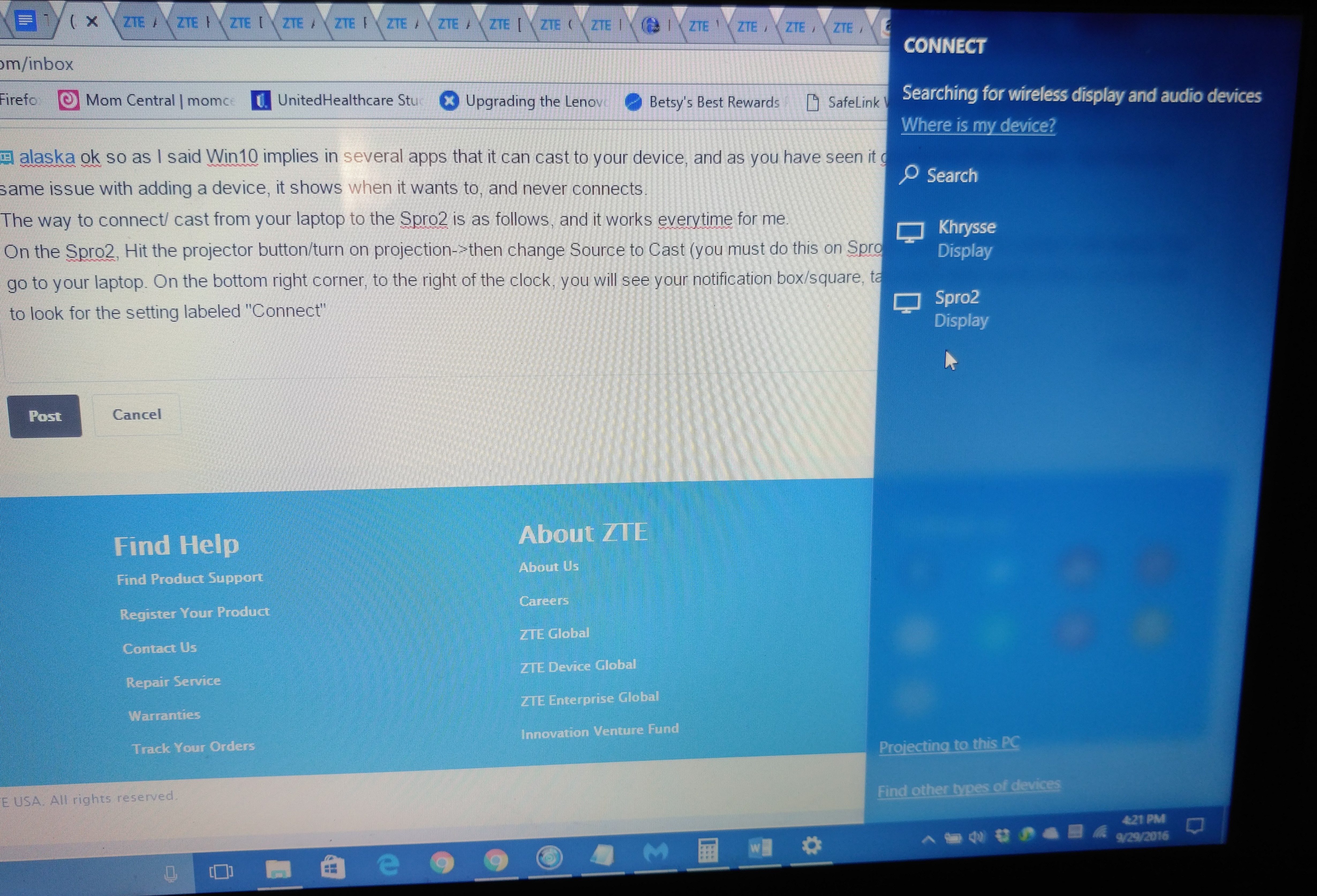

    ​ ok so as I said Win10 implies in several apps that it can cast to your device, and as you have seen it doesnt work as it claims. I also have the same issue with adding a device, it shows when it wants to, and never connects.
    The way to connect/ cast from your laptop to the Spro2 is as follows, and it works everytime for me.
    On the Spro2, Hit the projector button/turn on projection->then change Source to Cast (you must do this on Spro2 before trying to connect with laptop)
    Now go to your laptop. On the bottom right corner, to the right of the clock, you will see your notification box/square, tap that to open up the menu (sometimes you may need to click expand), you now want to look for the setting labeled "Connect"(pic1) and then you will choose Spro2 from the list(pic2).

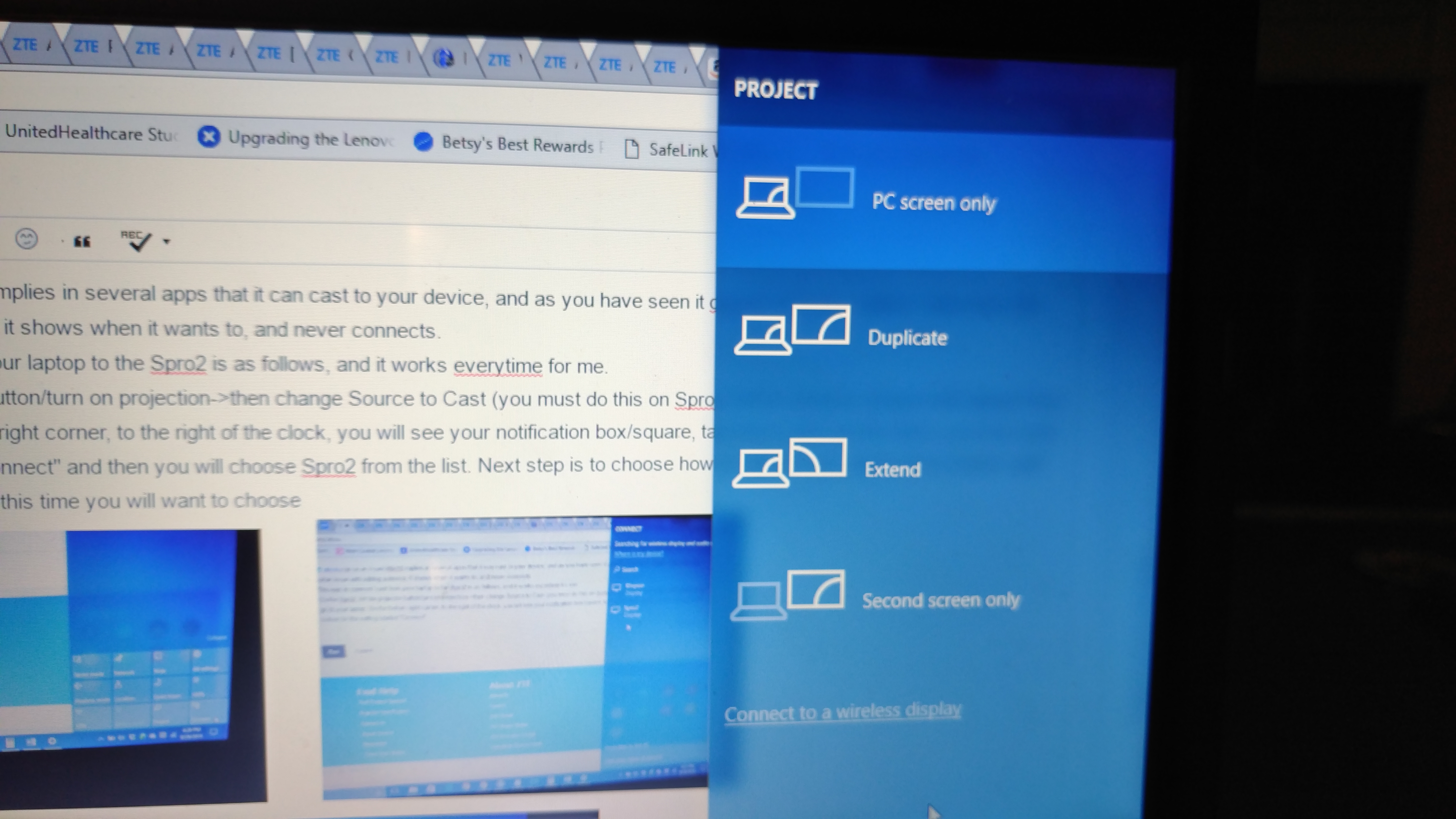

    Next step is to choose how to want to cast, Again down bottom right corner, click the notification box, this time you will want to choose "Project"(pic3) from here you need to choose what option works best for you(pic4). I choose duplicate, as I need full control of my laptop obviously.It can take 30-40 seconds for it to cast over sometimes, so wait a sec If you need any further help please ask.
  • No Joy. I know all the steps, but tried your's anyway. The Spro just does not show up in the list to choose from. Wifi is on, bluetooth is on, Miracast is on. If it is not hooked up via cable it does not exist. When I go to add devices, nothing.
    Any other ideas?
