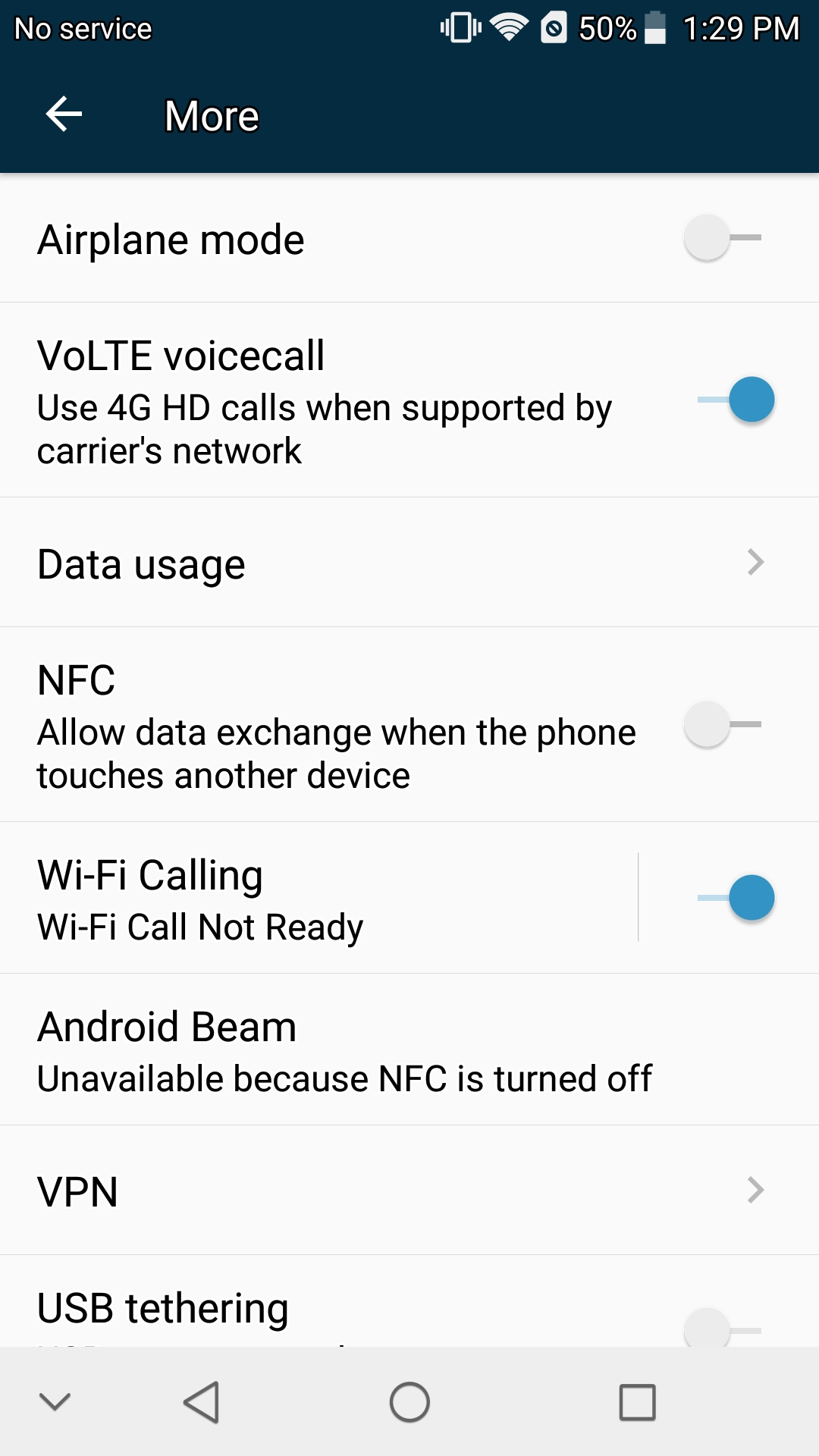

    why does the phone have WiFi calling in the menu if we can't use it, I have mintsim and the connection is good everywhere except inside my house I was hoping to be able to use wifi calling :'(

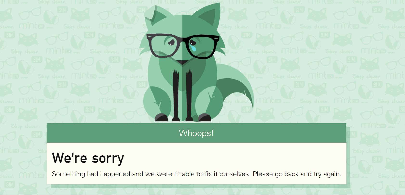

    @ram1220 do you have the Axon 7 mini ?
    @ashishv thanks for that
    -so when I go to enter my 911 address and enable wifi calling on mintsim I am getting an error message..
    "We're sorry
    Something bad happened and we weren't able to fix it ourselves. Please go back and try again."
    i should be good?

  • ashishvashishv Posts: 23 ✭✭✭✭✭
    @zteuser95 said:
    "We're sorry
    i should be good?
    I have never seen this error on my side, maybe try calling Mint and explain your situation?

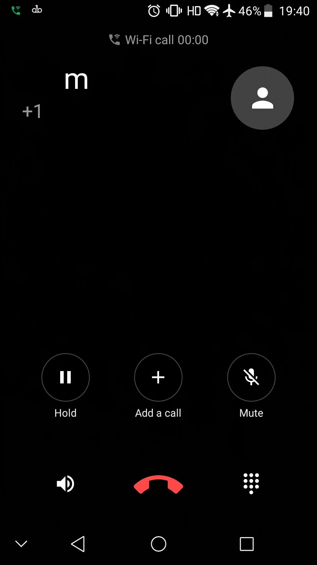

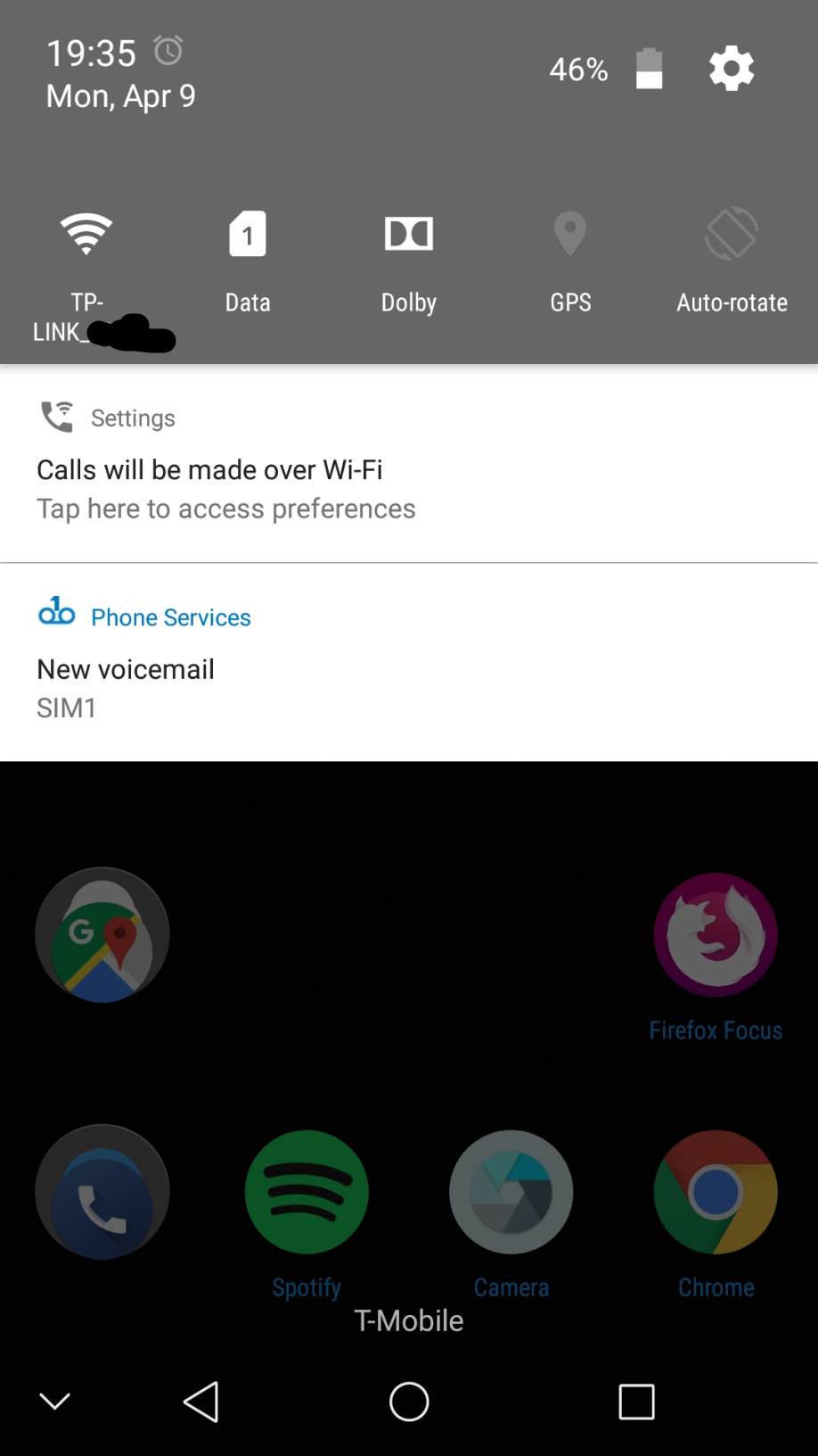

  • kmb877kmb877 Posts: 164 ✭✭✭✭✭
    On Axon 7, wifi calling works wit Mintsim and Ultramobile. You need:
    • to setup your e911 address with Mintsim, Ultramobile or T-mobile,
    • to use the SIM1 slot (wifi calling does not work with SIM2).
      However, I had myself problems connecting wifi calling (error 82). I did a factory setting reboot and the problem was solved. Abvious, the phone has all updates installed.
