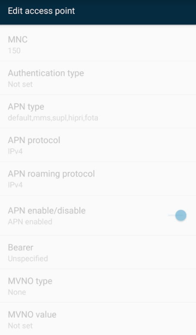

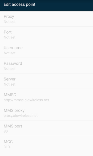

    which plan do you have @chavo ? Ive got the unlimited plan with cricket and not having issues with hotspot on my Axon 7 mini with nougat. Im able to get my laptop, Axon 7 and a friends Iphone all connected to my hotspot and getting decent speeds
    Can you confirm all your APN settings match mine?
  • ilovetofuilovetofu Posts: 7 ✭✭✭
    @musicdjm I'm on the 4GB plan and my APN settings match yours: http://imgur.com/a/Y3bKG

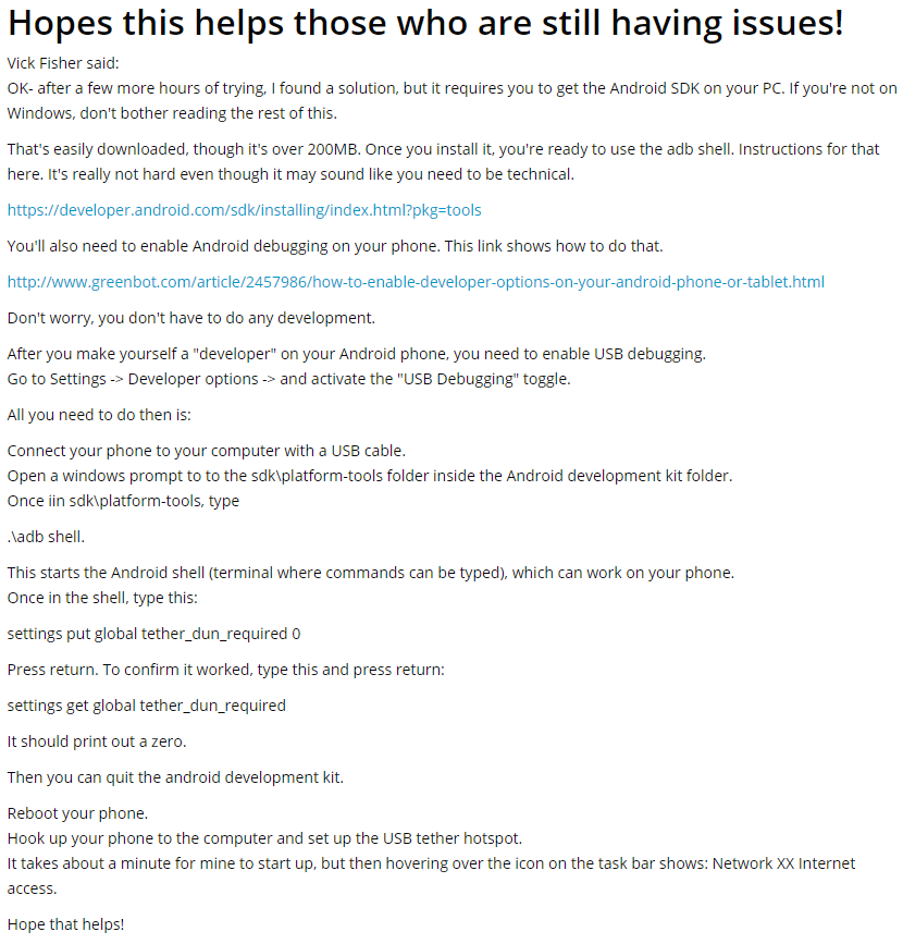

  • 22david22david Posts: 1 ✭✭✭

  • mrmcgreengenesmrmcgreengenes Posts: 22 ✭✭✭✭
    @22david said:
    So after many instances where my hotspot would show connected but my laptop or PC would show no internet I hand coded the IPv4 DNS to google's 8.8.8.8. and 8.8.4.4 (laptop and PC) and I have not had that problem since.
    Good to know, thanks! Anyone else who is having trouble confirm this as a workaround fix?
  • azuth01azuth01 Posts: 7 ✭✭✭✭
    edited July 28, 2017 11:56AM
    Did not work for me. My wife's mini has a functional hot-spot so I went ahead and used the warranty to get a new phone.. After it updated the hot-spot quit working. Frustrating

    After the latest update my hot-spot no longer has internet access. I can turn the feature on and connect to it with my laptop, but it says no internet access. My wife has a mini also but I can access the internet from my laptop using her hot-spot.
    Have you tried wiping the partition cache at all @azuth01 ?
    I did a factory reset, then I traded my phone in under warranty. The new phone had speaker problems and the hot-spot on it didn't work. I am now on my 3rd device that I just received today. I did no back ups, updated the stock mi favor rom, activated the hot-spot, connected with my laptop and my laptop says it has no internet service.I have also tried changing my laptops IPv4 DNS to 8.8.8.8 to no avail. Unfortunately I know next to nothing about phone tech/interface. I figured a new device from the factory with nothing changed but an update should work.
