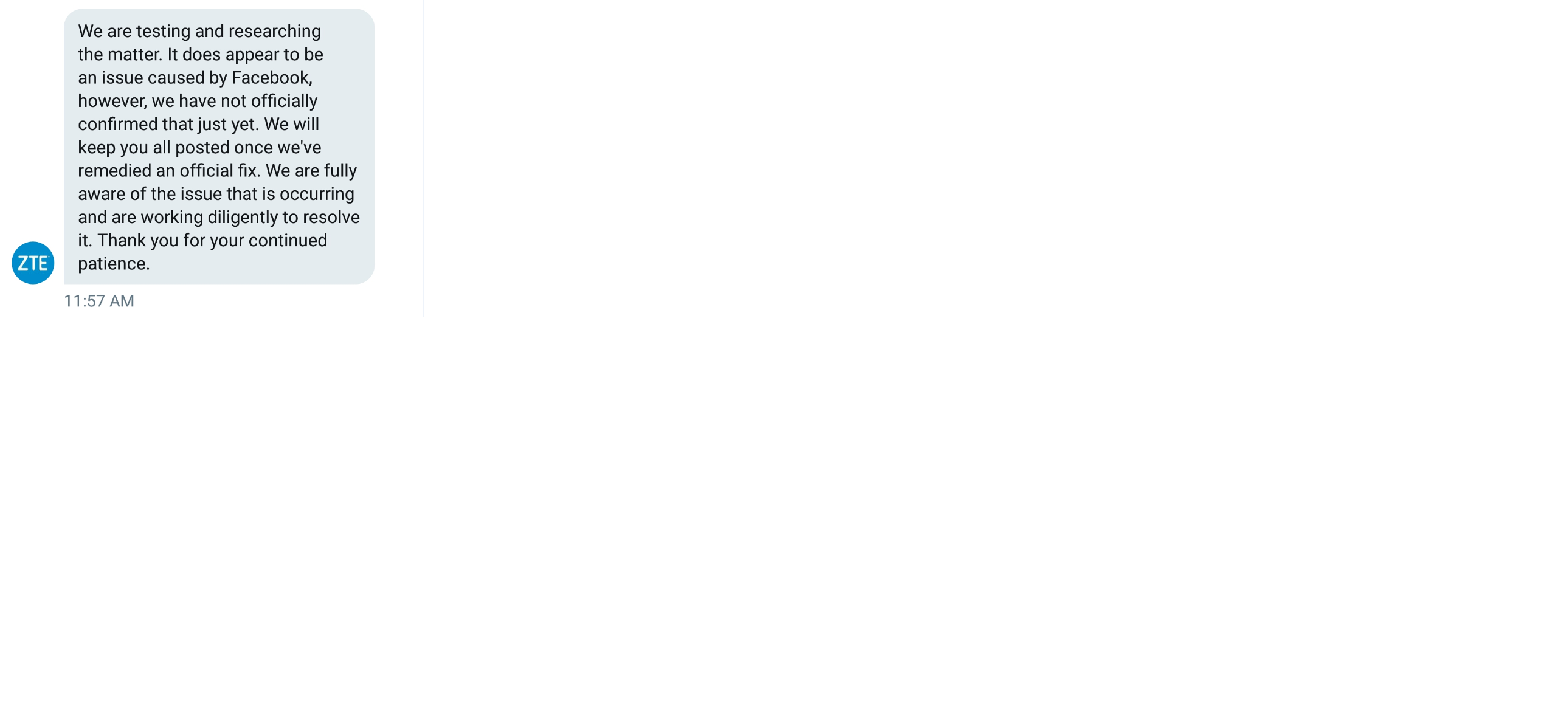

  • amantomamantom New YorkPosts: 6 ✭✭✭✭
    Got an update from ZTE on twitter. They acknowledge that it is most likely from facebook and are working on the fix.
