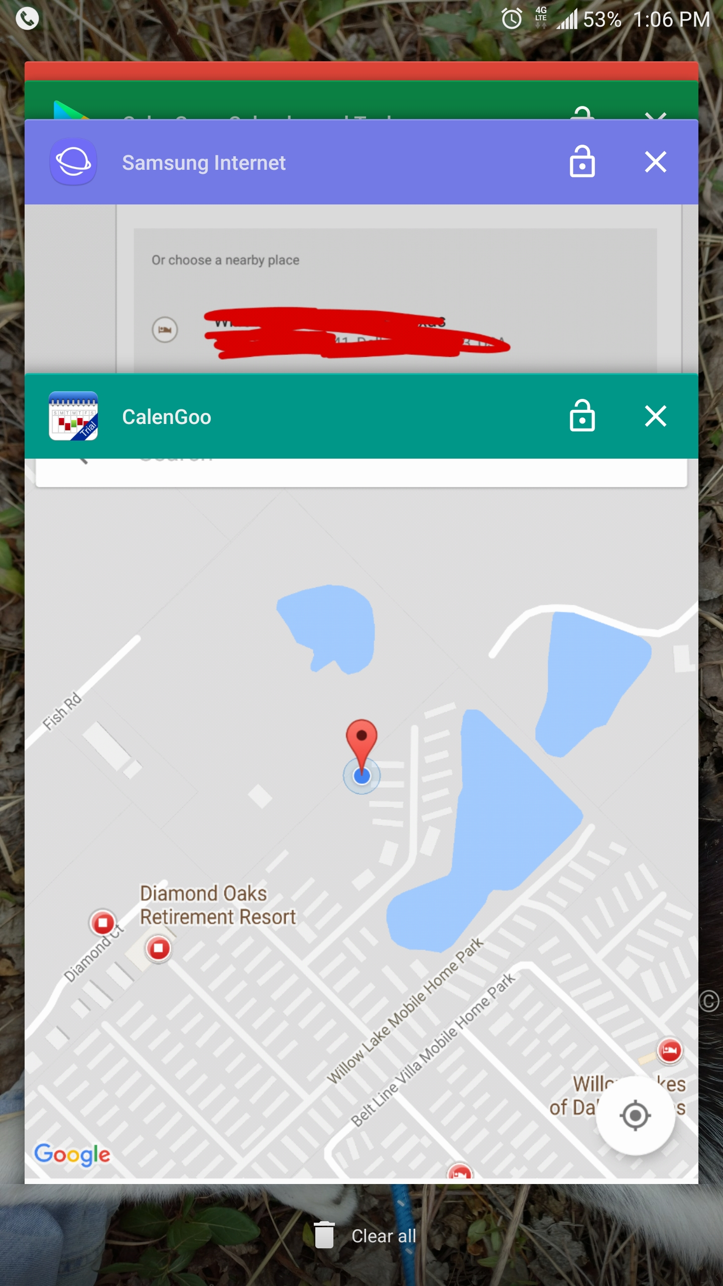

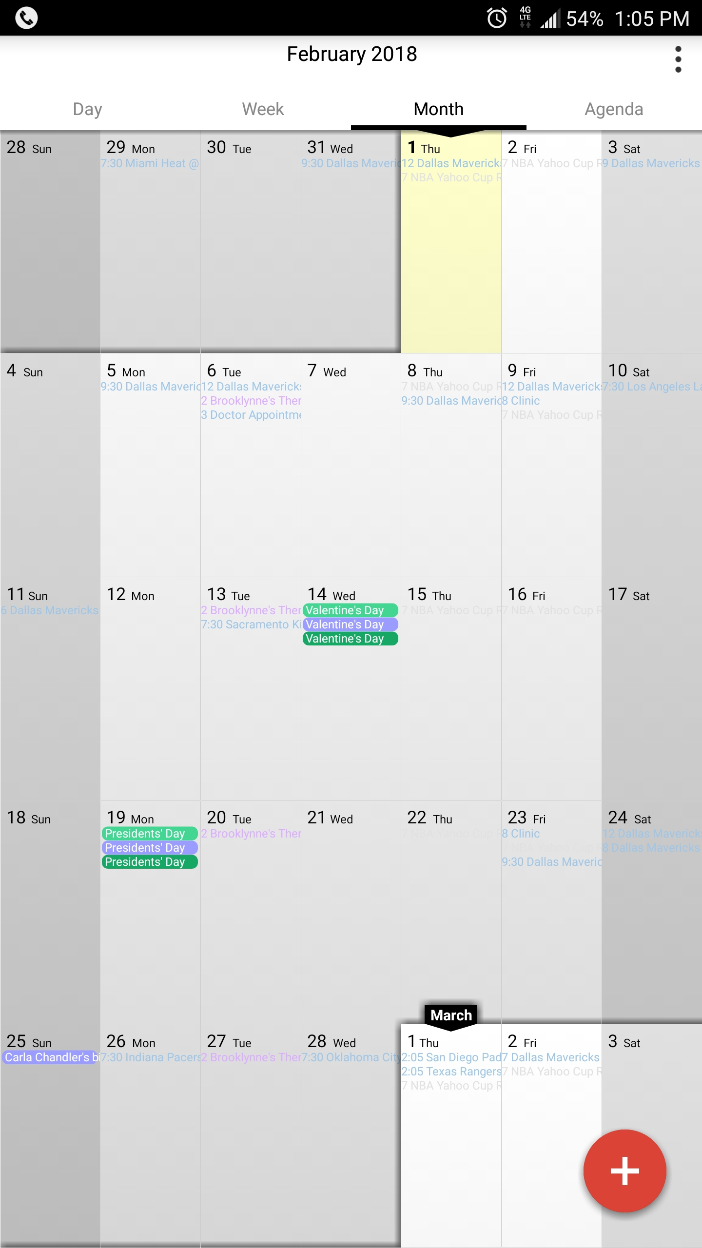

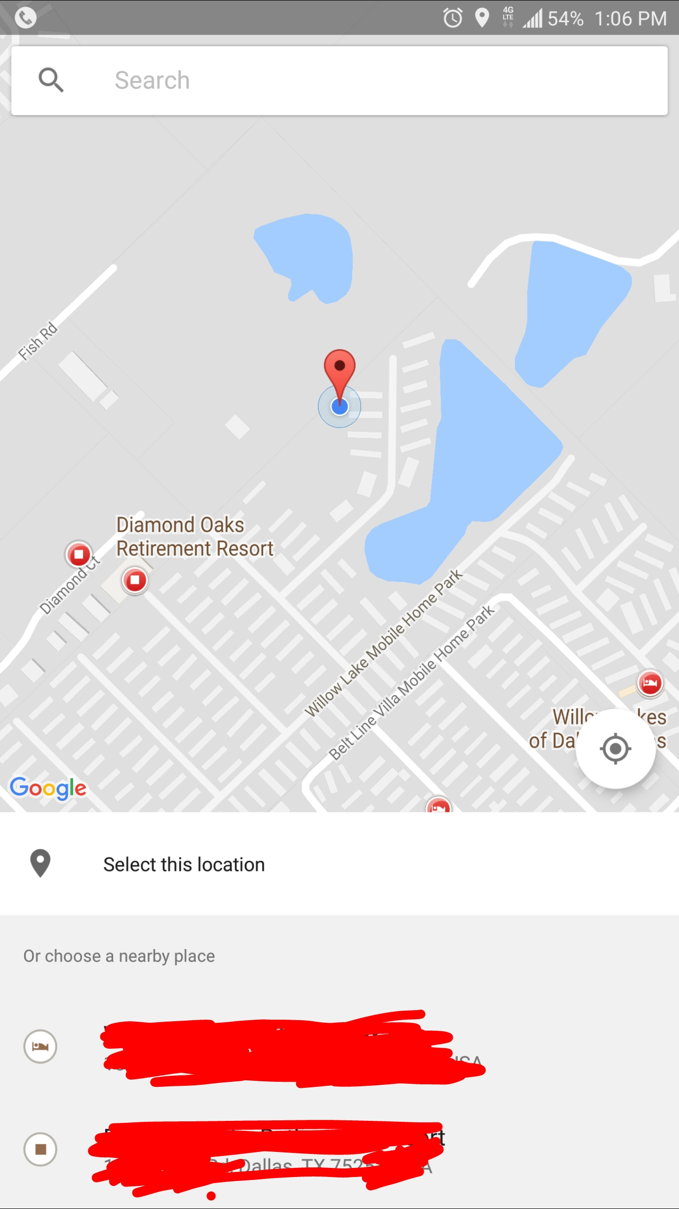

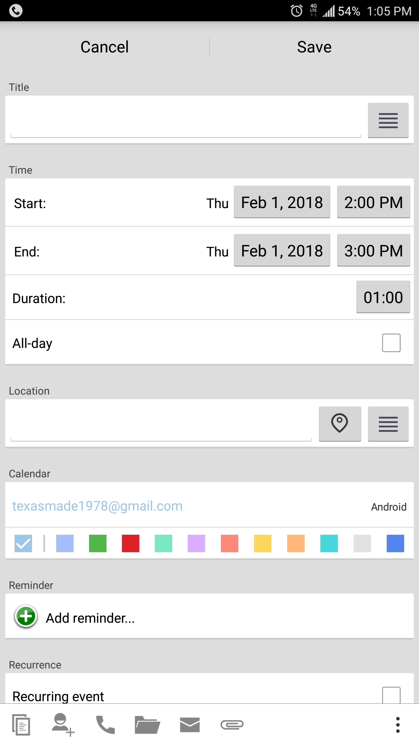

    @texasmade1 thanks for checking this out for me. The screenshot doesn't look like CalenGoo. In CalenGoo create an appointment and set a location. Once that's saved you have to turn on the setting to show the map in the appointment's detail view. To do this go to "Settings > Display and Use > Detail view > Show on map". Now go back to the appointment and select it to view the detail view. Please tell me if you see the map and location in that view or if you get the error message that I stated in my previous post.
    Thanks to everyone who's helping me with this!
    edited February 1, 2018 2:11PM
    It's the CalenGoo App
    @wrbird You are correct, I got the Geo fail error as well. However the GPS/location services work in every other part of the app. This seems to be a very weird bug, as GPS/Location services work with every other location based app I have tried it with .It could very well be related to the B35 update or to the app and it just not playing nicely with one of the changes that the update implemented. Anyways, good luck on this getting fixed as I know it sucks to have an app not functioning properly.
