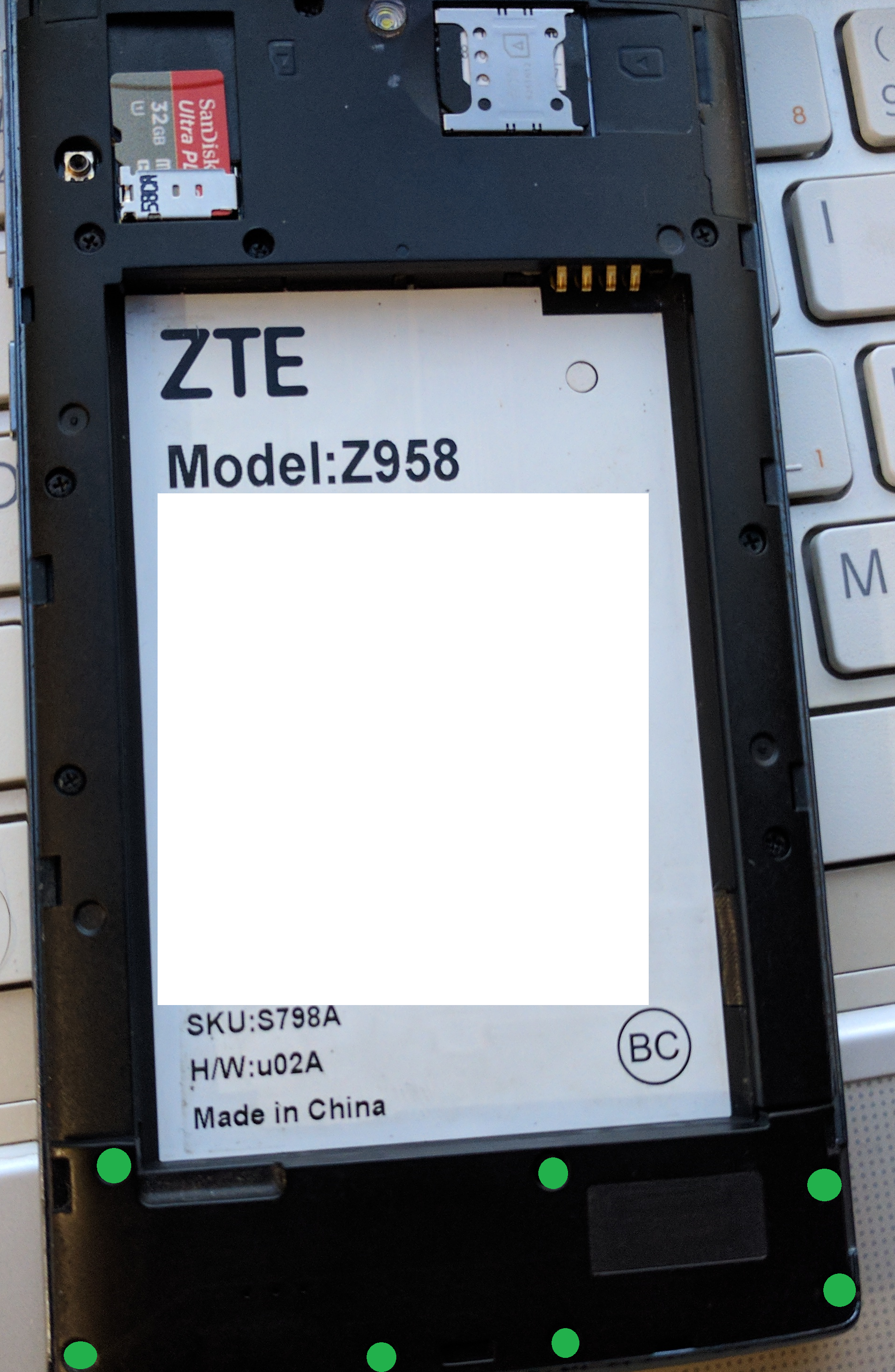

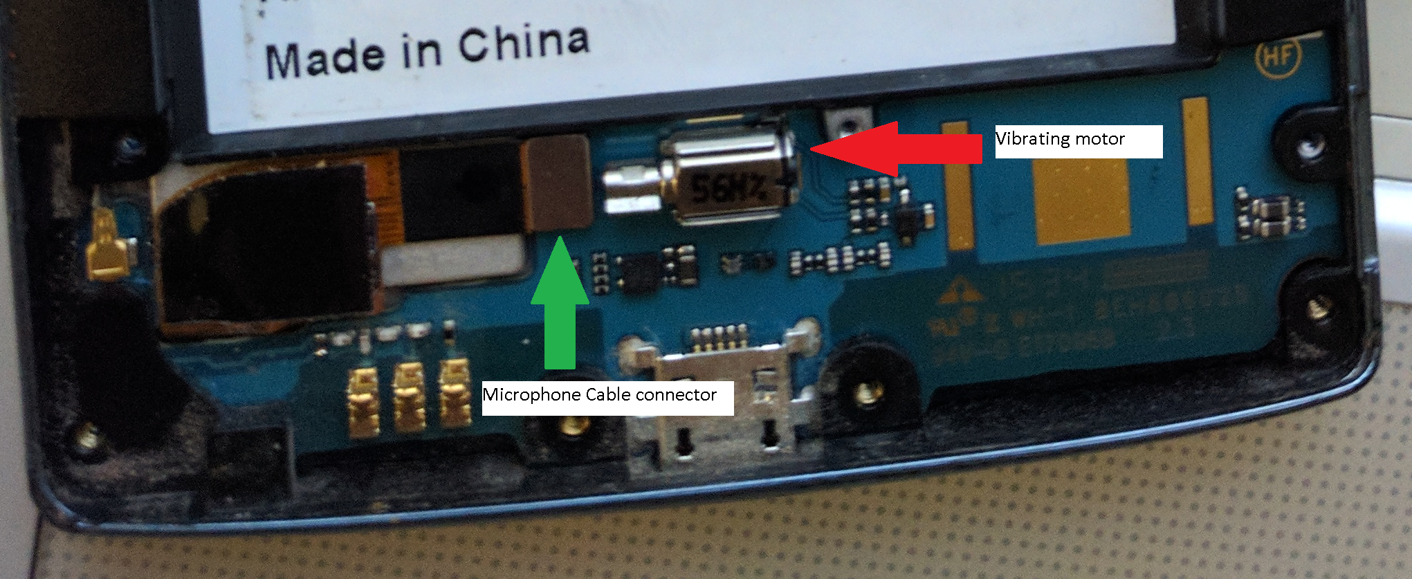

  • I had an issue with my microphone not working at all. It was not after the B24 update however. I fixed it, I think the issue was that the phones vibrating motor is near the connector for the microphone causing it to slowly vibrate loose. I disconnected and reconnected the ribbon cable for the microphone module.
    I know many do not want to take apart their device, but thankfully it is easily accessible.
    You'll Need:
    * Precision Phillips head screw driver
    * Thin (non-metal) prying tool.  (A flat head screw driver will work. Plastic is preferred so accidental scratches don't happen. Low risk of that happening, so that's your call)
    First:
    Remove the battery cover and remove the battery. Unscrew the 7 screws along the bottom of the backside of the device (They're small and easy to loose, I was able to unscrew them all without actually removing them so that when I lifted up they all stayed in their holes)Screws.png
    Next:
    Gently pry upward on the silver connector of the ribbon cable. You may even be able to use your fingernail here) open panel.png
    Push back down on the connector (you'll feel it snap into place) and replace the plastic panel and screws.

  • I created this account to say that this is the solution that worked for me.  I bought a set of precision screwdrivers to do this.  The head you will need is J000.
    I previously had a phone that was able to make calls, use sms and data but no one could hear me through the phone or Skype/G-chat.  I would hear my own echo but the other line could not hear me at all.  Speakerphone did not work for me either.  I initially thought it was a software issue, so I tried downloading SoundAbout to change the source, after that didn't work I knew I had a hardware issue.  I found CJE200's picture above and it seemed very plausible that my microphone port was loose because I drop my phone quite often.  I opened up the back, unplugged the ribbon completely, blew on the area, and then plugged the ribbon back on and VOILA!
    THANK YOU​​  !!!!
  • Holy cow. Cje200 you are the man! Performed the same steps. Then tried to test microphone by doing a voice recording and it worked! Did same steps as others. Unplugged, blew on it little, then snapped it back in and it worked!
