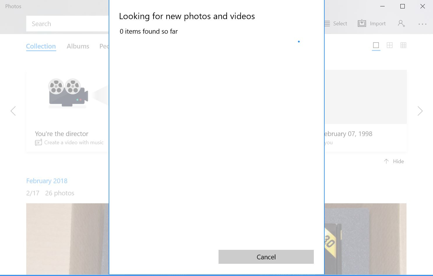

    It is not the scan on the phone - it is the Photo App in Win-10 attempting to "SYNC" the PC to the phone. I have managed to get options changed/killed so that I could force the PC to let me select what function I want when the phone is connected in MTP mode - changed to display the phones folders - so now I get the phone and folders to show up in file explorer like I want. It is still doing background search functions which I can see in Task Manager but it lets me get to the files on the phone. Still not happy using it as it drives my CPU cycles to the limit and CPU Temp high as well (I overclock to 5000MHZ and monitor fully the CPU). Pic is attached. I still do not consider this fixed as the PC Connect function still does not work.
