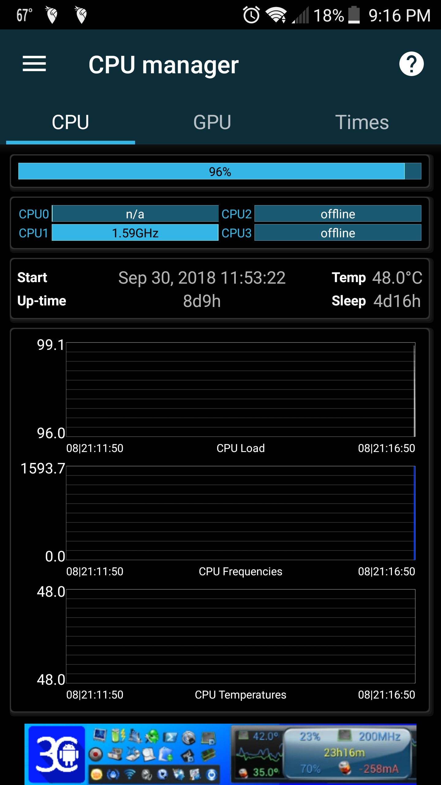

    i have it open and and while idle i saw all of the cpu boxes go to 307 but the top bar is going 16% 19% 15% 25% 54$ etc etc..And then randomly the cpu boxes jump to 940 or 960 ...
    Is there anything I should keep an out for when this lag bs starts? just **** cpu screen or something else maybe?
  • maverickmaverick NJPosts: 420 ✭✭✭✭✭
    phone is at 50% and i see the top bar in cpu manager showing 90 or 30 or whatever. all over the place. at one point cpu 2 and 3 were "offline" or whatever then all 4 are 2.15... shits all over the place heh
    Yo @razor512 check this **** out.... Lol
  • razor512razor512 United States Posts: 2,510 ✭✭✭✭✭✭✭✭

    But why are two offline and one N/A? That i dont get.. the N/A did come back on eventually while the other two were offline (power save mode was turned off).. And yeah trying to watch a youtube video is torture at low percentage.
    If the app fails to get the requested data, it will display a N/A value. Since the CPU does not look like it is being pegged at max clock speed and 100% load, I recommend checking the power settings and ensure that you do not have a power saving mode or a low performance profile set.
