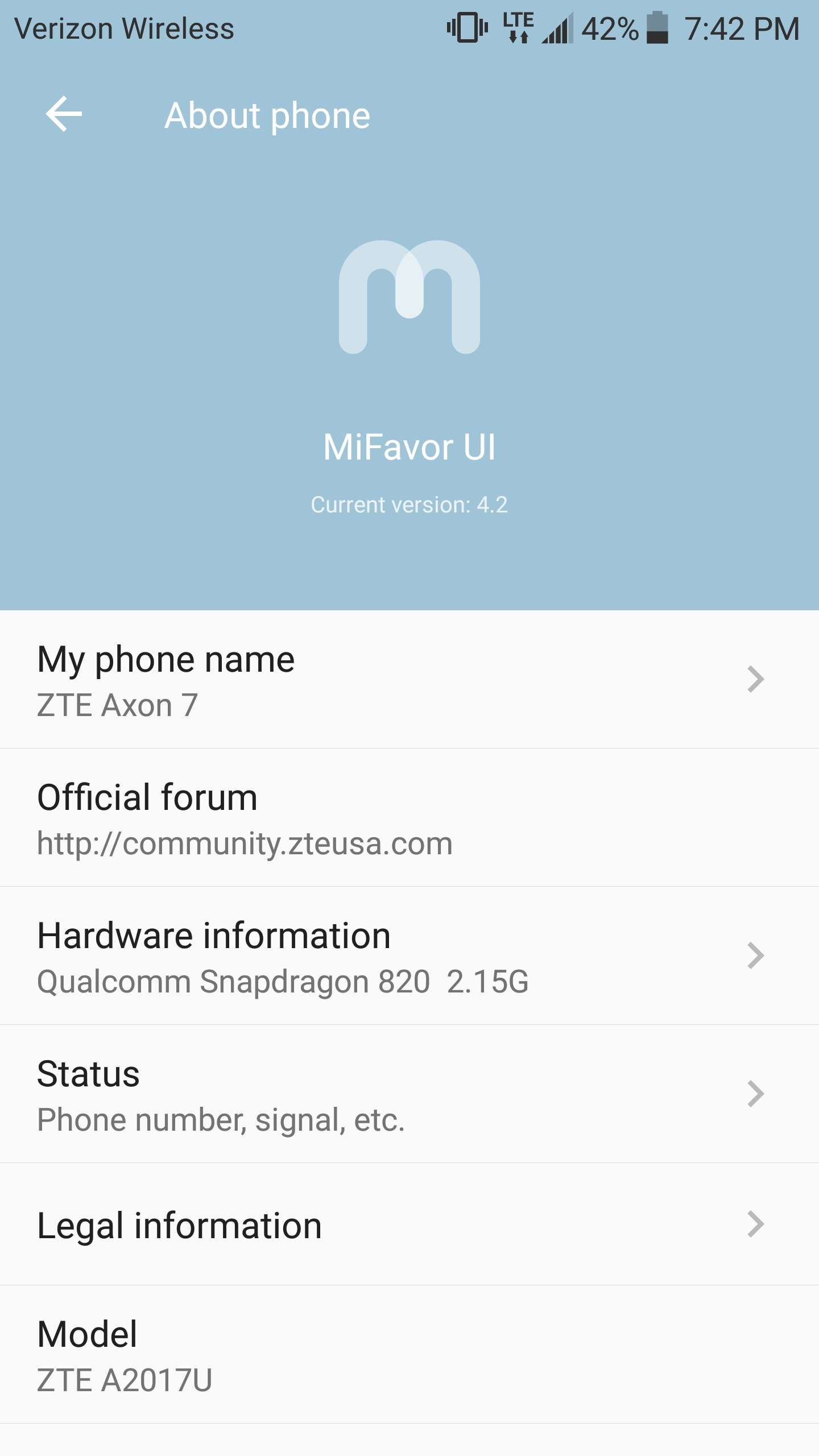

    Hello all, this is my first anything on the ZTE Forums, very nice community, lots of passionate people. I personally am still on my parent's phone plan, Verizon, and was looking for a good, decently cheap phone as I'm a college student. So I have the ZTE Axon 7, and this post is what spearheaded my decision to get the phone. Now I'd like to share my experience with the phone on Verizon to let anyone who wants to know be able to use it.
    PROCEDURE
    So basically, When I started with my phone, I had kept it on marshmallow as I was awaiting something before I could activate it, I'll explain in a moment. I recommend you do NOT update your phone until you are ready to activate it with a SIM Card.
    1.Get an active SIM Card. Your previous phone will probably have one. For me, my phone had a MicroSIM in it, which I thought was a problem considering the NanoSIM Slot on the Axon 7, but an $11 SIM Card cutter off Amazon does the job perfectly.
    2. update your phone to the latest Android version. Ensure you also update your MiFavor to the most recent version as well
    3. Shut Off the Phone.
    4. Insert the SIM Card.
    5. Turn on the phone. You may have to restart it a few times.
    6. Under settings, go to data, and make sure all your data settings are turned on for your SIM Card
    RESULTS
    You should now have a ZTE Axon 7 on Verizon! No roaming Icon, full LTE, and call and text. And if you saved all your contacts on your SIM, then you will have your contacts transferred over as well.
    Attached are screenshots of my top bar showing LTE, which were taken on the Android info screen to prove they are real.
    I hope this helped anyone who needed it. :)
